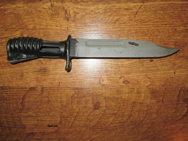

Ok, got the bayonet today. It was drop shipped from the UK.  It's in well used condition but has all the moving bits.  It's clearly been stripped and re-sprayed but all in all I'm pretty pleased.  Now I just need to find the infantry scabbard. I also have to fit it to the flashhider.  The airsoft ones are a bit larger than standard so I just need to figure out how to overcome that.

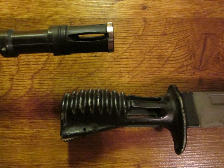

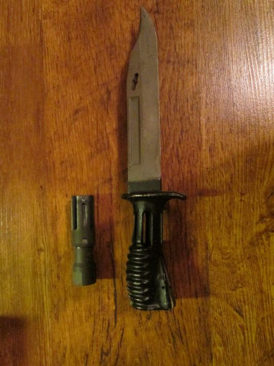

So I've been trying to make the bayonet fit the flash hider on my G&G and it turns out it was stupid easy.  Emphasis on stupid...
First I only measured the front crown and just ASSumed that the rear crown would be the same thus making grinding down the works not worth the effort.  So on my way out of town I ordered the surefire replica from RSOV because they said it would fit an SA80 bayonet.
It arrived about the time I returned home and I've been messing around with it for a week trying to make it work.  Some polishing allowed it to sort of fit but even when forcing it into the bayonet socket it just didn't lock up properly.
Actually having the calipers handy I was puzzling over the problem when I decided to fully measure the original flashhider and found that less than 2mm of grinding on the front of the birdcage hider was all that was needed to make it fit the bayonet.  The rear portion was correct STANAG measurements.  So, $30 poorer and about 20 minutes wiser the bayonet now fits the SA80.  The great thing is that the original flashhider looks streets better than the modern SF flash hider anyway.
 Surefire replica
Original flash hider with ground area shown
